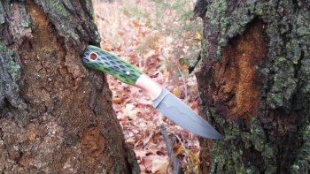

I wouldn't know much about the brine. I know it does perform well in the field. I recently finished one up for a guy using it. I quenched it in Parks 50 and used Rutlands furnace cement. It had a very nice hamon. There are lots of variables, but it's not hard. The brine is just too risky for me. The Parks is very fast oil without the risk of cracking the blade. My customer had no complaints on the performance of the knife. He took it to Texas and used it on 3 whitetail and said it was still shaving sharp at the end of the day.
