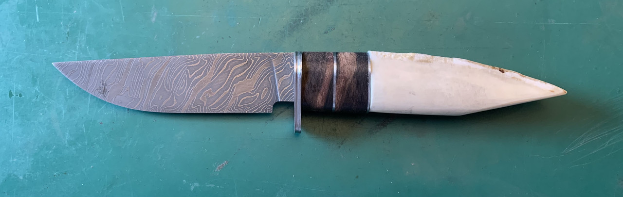

Working on a final fit up before epoxy.
Can you clarify on the magnet positions?
Sure, the top magnet is inside the branch in the lower half. I had to cut it off, hollow out an area and then put the magnets insde. Then glue that section of the branch back on. The base I just drilled up from the bottom about 2/3rds of the way through the board, put the magnets in and then glued them in place. You can balance the knife either way, tip up or tip down.
