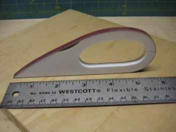

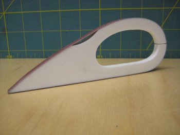

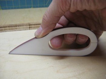

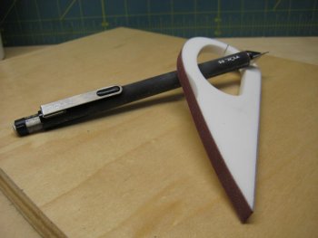

.......and maybe pass it around. It's my new detail sander. .250 Corian lovingly shaped to fit a 12 1/2" X .250 Micro Belt. Thumb detent on the top let's you add more pressure to the belt and the little relief slot in back let's you get the snug belt on. All I want is some feedback and maybe pass it around to try. First "I Gotta Have One of Those" posts and PM's your address and it will be in the mail. Note that the radius at the back is actually an ellipse so it should fit most any inside curves.
Thanks in advance,
Steve
P.S. I think I got the last .250 Corian that Dupont ever made.

I got to use the sander the last couple of days so here are my views.
The design is very nice, it fits in your hand well and is easy to use.
The shape has plenty of different curves to get into hard to reach areas.
The belts are nice and tight, almost to tight. I would like to be able to spin them around a little easier so I could keep a fresh part of the belt where I'm using it most.
The width is perfect, it gets places where my other sanding tools won't.
I don't know if there are any finer grit belts out there. I would like to have a 400 grit as well as the 180 and 240.
Overall a great tool for finishing up the tight spots. Well thought out and executed.
Now the Big Question...Can I Keep It?
It's your Chris. It's small payment for your honest review. Thanks for the feedback.
Just take a little off the Corian and the belt will loosen up. I kept one that I overdid and the belt was loose and I wrapped one layer of 1/4" blue masking tape around the perimeter and it works pretty slick.
Thanks,
Steve
Thanks Steve,
I'll put it to good use! Now that it's mine I'll work on loosening the belt a little.
Chris
