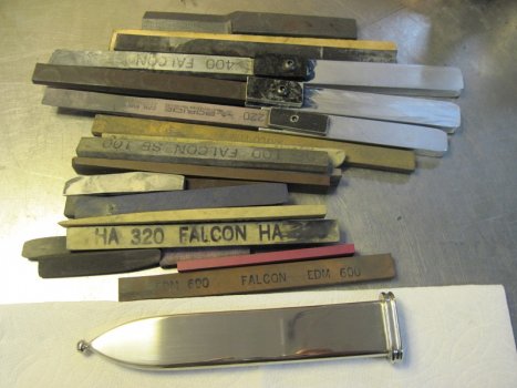

I have used tool and die maker stones for over 20 years, in my opinion they have sand paper beat in many ways, they last longer, are much cheaper to use, keep your edges sharp, keep your blades flat, have used them on hollow grinds and gun barrels. You can get hard and soft stons that will ware to fit the shape you are working on, I use them with oil, thin it for finer grits, you can use water but it makes my fingers split. They do make a powered tool for them don't know who makes them. Falcon Tool and Boride are two makers of good stones, what ever grit you stop at you will need to finish by dragging with sharp sandpaper. Works for me. Deane Went to Falcon tool web site, they have the pneumatic tools, they call them u-lap air profilers in three different stroke lengths they are $400.00
