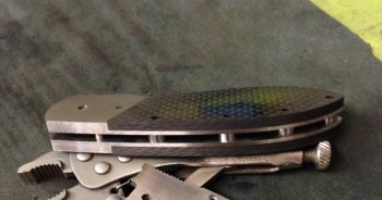

Here are some photos I took today for a WIP for my Facebook page. These may help you understand how it's done.
The bolsters are held in place with a 2-56 pivot screw and a 0-80 screw that threads into the liner. The scales are held in place with 0-80 screws that go through the scales and liners and into the spacers.

I've got a 2-56 tap - it's so tiny I can't even imagine trying to tap one of those 0-80 screws! WOW - I'd need my microscope to even see that tiny thing! My hat's off to you Calvin and all the rest that work with those tiny things.
Ken H>
