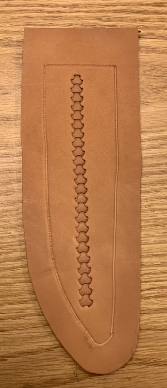

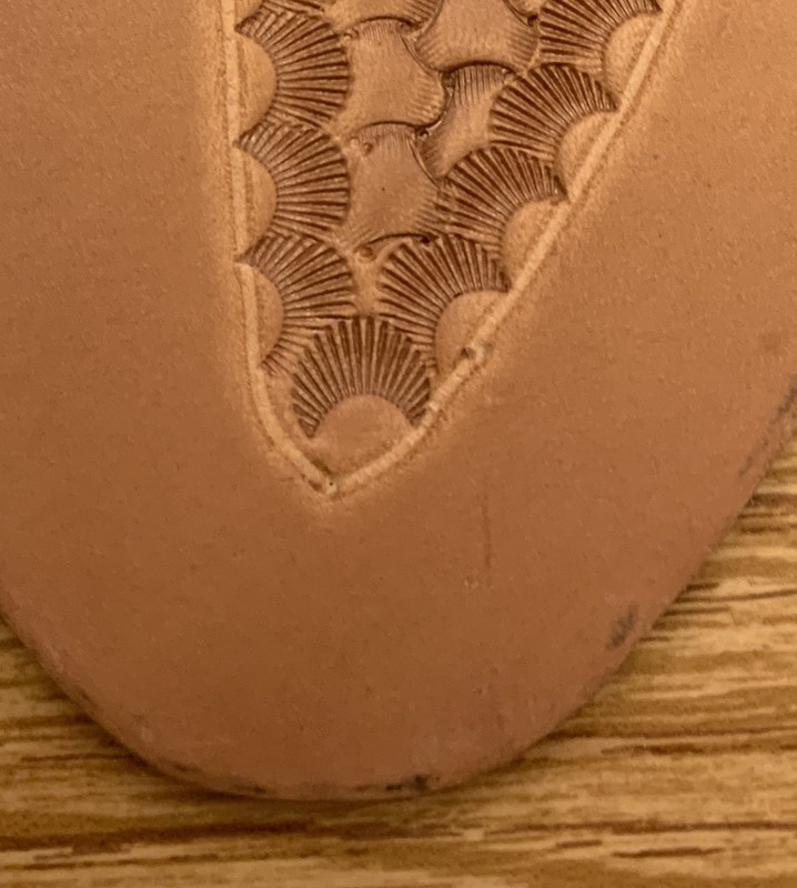

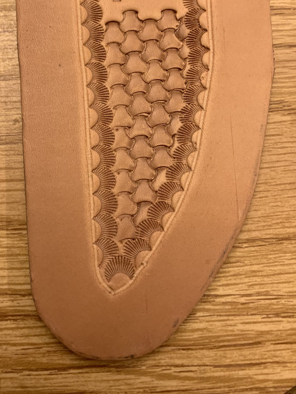

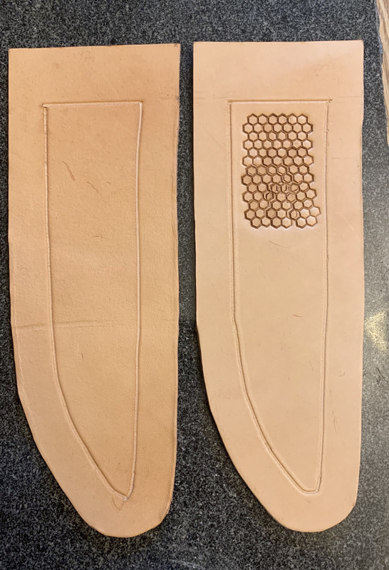

Now all I have to do is keep lining up the stamp. Whoops! That did not work out very well. I got off on one stamp and it exploded from there. Time to cut a new front cover. I need to start over as I cannot save this piece. Grrrrr!
Stamping is either right or wrong. There isn't any half measures with them. That is an interesting stamp though. I have quite a few but it is the very slight misalignment that spoils the effect so I stay with very simple border stamping when I do it at all now

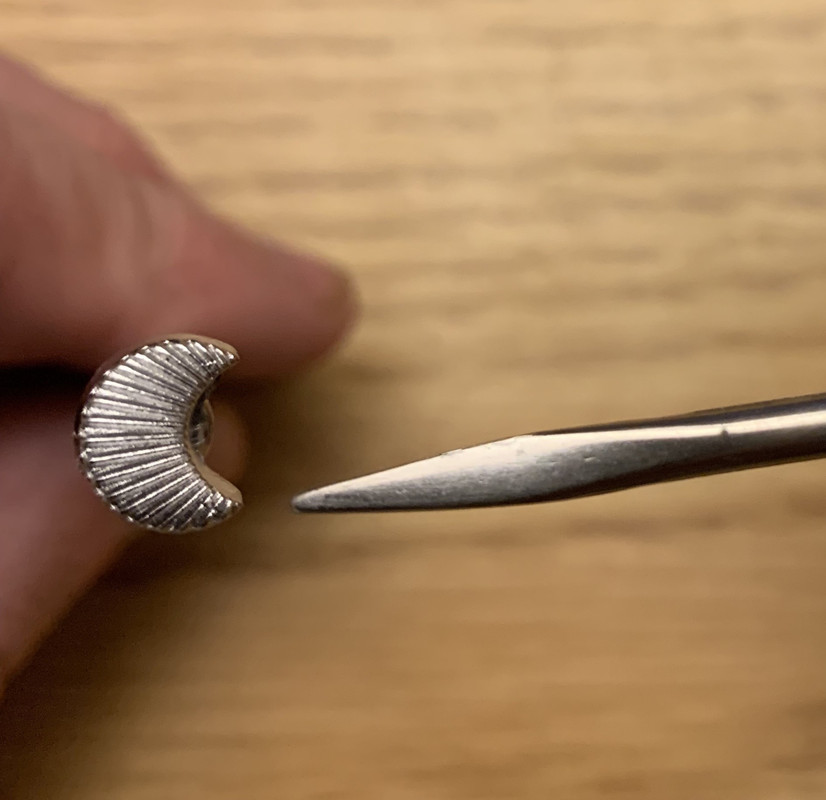

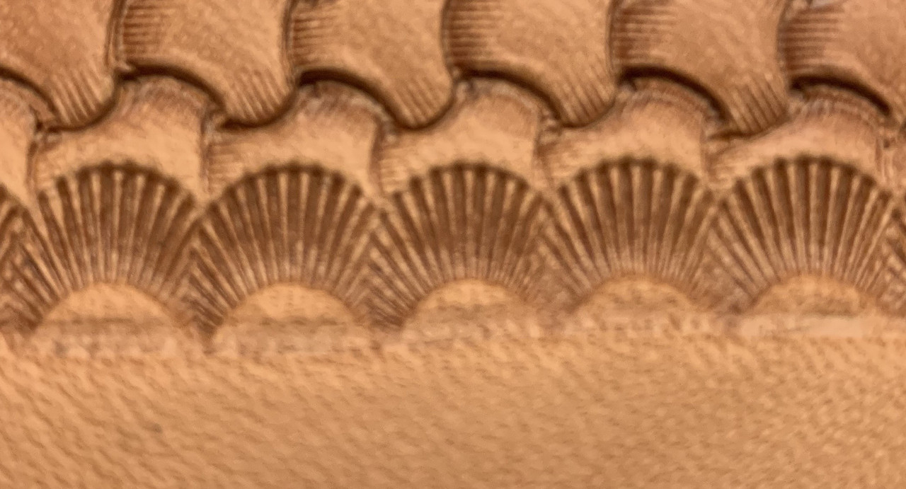

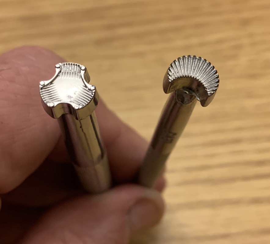

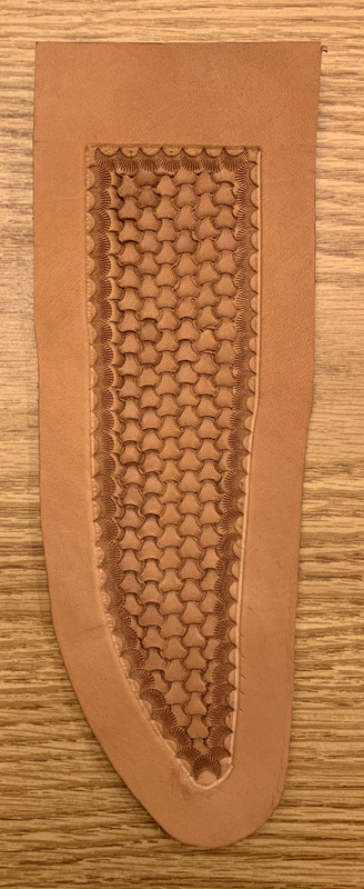

Nice job on the stamping, that's alot or real estate to keep straight. I like how your edge stamp looks how do you align it?
Justin - I use the bottom points in the groove and just stamp touching the point, to the next point, to the next point, etc. Follow the groove around. I hope that makes sense.
