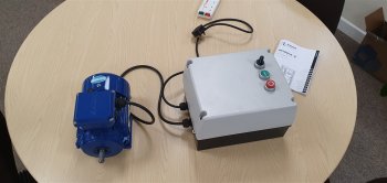

I just contacted a couple of suppliers , one sent me a link to a motor plus a speed controller but the other supplier sent me the image of what he has just made for someone but for another application. I said its a maybe.....if he can make the box smaller and ensure its dust/water spray rated and the correct speeds etc.
