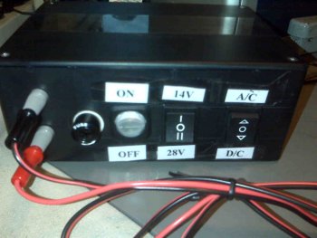

This is one I just built for someone. Dual voltage, with AC and DC. The dual Voltage helps not burning up stencils so much.
