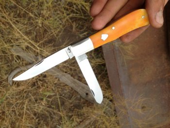

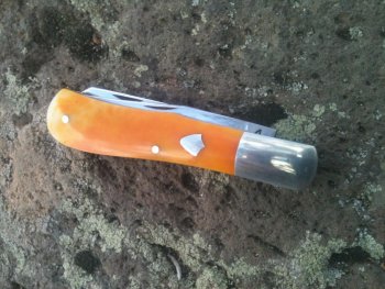

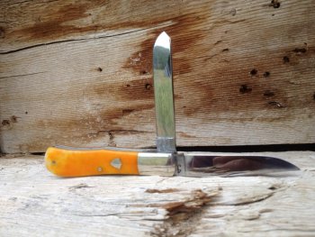

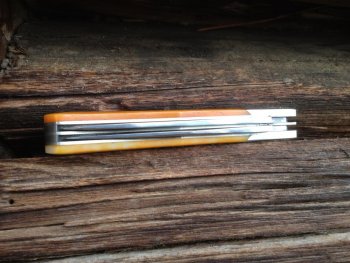

All right first two blade. Finally got Internet at the cabin. Been anxious to post these. Also got caught by a tv crew last spring. Goes to show you they'll put anybody on tv.

Thanks for the kind words. It could have a better finish on it. But I have a bad habit of fussing with something till I screw it up. I have learned to live with small flaws and try to do better on the next one. Each one is a learning experience for the next.
There was only one perfect man. A knifemaker knows all the little flaws in all his own work. You can't be perfect, but your knife is close enough.
