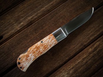

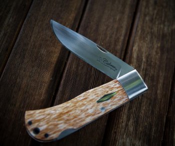

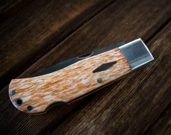

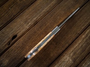

Finished this lock back folder yesterday. The blade, lock and spring mechanism are made from A2 steel. Handle material is giraffe bone with stainless hardware and stainless shield inlay. Dimensions are 4 1/4" closed and 7 1/2" open. Blade length is 3 1/8".
