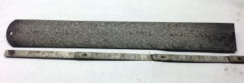

Here's a pic recently posted on the ABS site of a 'bare back' billet of 1095/L6/5160 of our Sat follies. As an aside, we're both geriatrics, so at this point have the attitude that 'nothing ventured, nothing gained'. Everything is game! Thanks Bob and JD.
John
www.gearhartironwerks.com
Gearhart,
Are you using the kerosene soak at low heat to set the initial welds and then ramping to 2350f? I understand that welding temps are lower than we all thought at first but if you are soaking for 15 min at 2350f for the first weld, unprotected I think you have forge scale inclusion. Please give us your bottom line results if you will.

Bruce,
Not knowing where to start heat wise, I picked 2325-2330, and everything welded nicely w/o scale, or use of kerosene,WD40 etc. It was a totally dry weld. I haven't had time to explore what the bottom temp line is, but hopefully someone will chime in. Soak time seems to be the key. After lightly tapping (air hammer) for the initial weld, soak times can be less for the next hammering cycle, in my limited experience.
Several yrs ago, Tom Ferry told me at that time he was welding at 2250 with soak times longer than 30 mins.
At Mt Hood last Aug, Bob Kramer said he felt that the welding actually happens more in the forge.
Fwiw, my forge is horizontal with a blown ribbon burner and uses natural gas.
John Emmerling
http://www.gearhartironwerks.com
I'm still not convinced that you can get a perfect weld without protection of some kind from oxygen. A fire simply won't burn without oxygen so it is always there. I understand that most of the welding happens in the forge if the parts are so close together that they actually are touching and not allowing air to get between them. A "loose" stack of steel has gaps that would allow air between them and would build scale. There must be a reason flux was invented. Please continue this discussion. I,m just saying but listening to all views on the subject. I'd love to toss out my flux bucket but need more convincing first.
Cuz Bruce: try it, you'll like it. Now my pants do not catch fire as often. As far as the scale, after the first weld I grind, cut and stack. Weld the billet only on the tang end, back in the fire at 2350+-. No flux. Wait and soak. As you can see in John' s billet, it welds. From near the front veranda, dlee
I guess there's only way to find out. :) Those white lines in my billets caused by flux contamination are gone now. I haven't tried a feather w/o flux but will do so soon ...and hold my breath.
John
