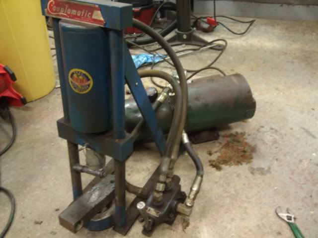

In real life I'm an auto mechanic, I know lots of folks who are collectors of "stuff" It may just be part of the mechanic's life to collect stuff that most folks would throw away. In my travels today I was at the shop across the street, which is an ag equipment dealer. I sometimes spend some of my lunch break over there talking shop with the guys. In passing I asked the mechanic out back if he had any old hydraulic cylinders laying around, as I would really like to build a forging press. We rooted around in the back room and found a few canidates, he said to take them and try them out, well I don't have a hydraulic pump and motor yet, which I informed him of. A little scrounging later we had uprooted an old hydraulic line crimper which is used to crimp the fittings on hydraulic lines. It had a 110v pump, a double acting cylinder of about 3.5 inches and a directional valve. Here's what I brought home with me today, I'm glad there are other packrats out there

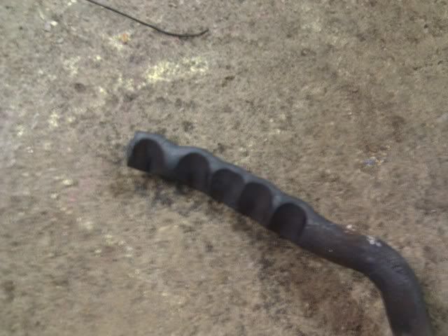

The pump wasn't hooked up to the lines but tonight I hooked it all up and gave it a test run. I plugged the motor in half thinking to short out a breaker and start a fire :) nope, just ran like it should. The ram moved up and down like it should, so on to fire up the forge to see if it would have enough power to move hot metal. I wired a piece of roundstock to the ram as you can see in the pic to act as a makeshift die and not to damage the piece it was attached to. Here's what I did to some 5/8 diameter coil spring in one heat.
While it isn't the power house that some of you guys have, it does move hot metal about 100 times better than my hammer. Now to make a stand for it and replumb the pump, I'm also going to make a couple sets of dies for it. I'm super excited to put it to use :) It's small enough I can put it in the trunk of my wife's car If I need to, and space is at a premium in my garage as well.

Make sure those hoses are in good shape, and keep 'em shielded from the hot stuff.
Thanks guys, I'm gonna replace the hoses as they're probably older than I am :) gonna relocate the valve too, some heat shielding for the lines would probably be a good investment too, thanks for the tip
