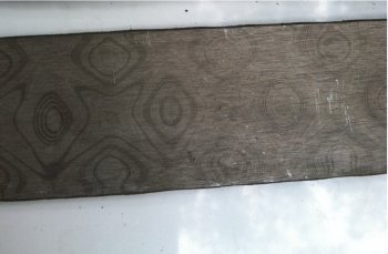

I bought some Damascus, one billet I suspect is stainless.
My challenge now is to identify if it is so I can heat treat it.
Any ideas please?
SS
KenH
Did you buy anything from Alabama Damascus? That sorta looks like a Raindrop pattern.
SS369
I did purchase some from Ala. Damascus. But not this particular piece.
I'm thinking maybe it is a pyramid pattern (?)

No you didn't post in the wrong place. I think maybe there are to many variables to what kind of steel it is. You might try a simple heat treat on a small piece to find out if it gets hard. Maybe treat it like 1084?

That's the pickle a lot of folks get into when buying damascus billets. Unless you can positively identify where it came from/who made it, and get a positive ID from the maker. all you can do is a guess. Based on the image, it's obviously a low layer count, generally indicative of stainless damascus, but that's just an educated guess. It could just as easily be carbon based.

Do you remember buying any stainless Damascus? That stuff is usually VERY expensive, more so than carbon based Damascus. If you didn't purchase any stainless, HT as a carbon Damascus and see how it works.

Probably not the one to ask here but, if you don't know what the steel make-up, you are reduced to trial and error. If you decide on the shape of your knife and anything that is not knife is a trial and error piece. HT it and take it thru the entire process. Just as you would the knife blade and then you can check to see if it skates a file.
If it did it hardened. That doesn't mean you got the full potential out of the steel that just means it hardened! You should be able to break the piece and look at the grain, and tell a little more about it.
