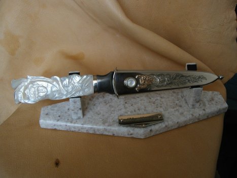

Chris, I made these stands to display my knives they sit on a battered stand on leather or other soft materials that would not damage the knife, the stands are made from corian, takes some time to make them, I would give them to the buyer of the knife a little added touch. Deane

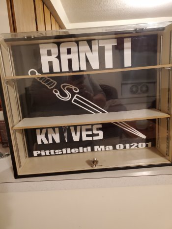

This is the case that I have that will be going to a shop soon (Hopefully, because of Covid)? Thanks Ed I was gonna pack my case but after reading your response I wont!!
