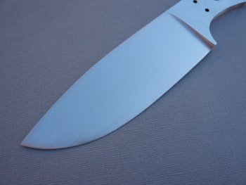

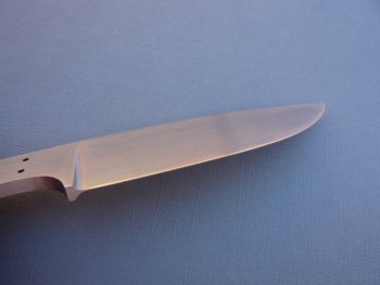

Not sure if this will help anything, but I thought I would throw up a couple of quick and dirty pics and dimensions, since that was asked about before. I'm not able to capture the remaining finish flaws in my crummy photos. It looks good from a couple of feet away, but under direct light with my nose almost touching the blade, they are taunting me to quit and give up :)
Blade dimensions:
1/4" thick 5160
~4 3/4" long (tip to plunge) x ~1 1/2" wide (at the plunge)

PJ, here's the way I avoid scratching. I start and completely finish one side all the way to finished grit. Then I clean the blade and put a layer of 2" wide painter's tape on, using a razor blade to cut away the excess around the edges. I actually cut the excess off using the razor directly against the edge of the blade so that my tape exactly matches the profile of the blade.
I then wipe off the leather, and often put a piece of tape over it as well and clamp the blade down. I don't use as much fluid as some. I used to use windex, but I had some discoloration problems on a few blades, so I switched to honing oil. I put a few drops down to start, and once it starts to dry up, add a few more. Just enough to keep the grit in play, but not enough to saturate the entire rig. Once I finish the second side, I tape it in the same manner and I'm good to go until I'm ready for handles.
That's just me, though. I know of others who use copious amounts of oil with good results, but I found that this works well for me. I also don't tend to use oil above 400 grit. No specific reason why, but I just don't.
--nathan
