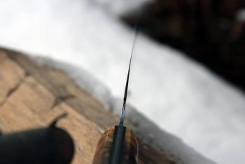

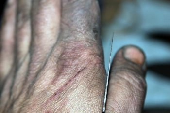

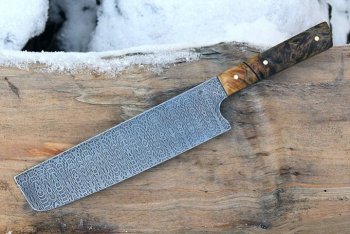

Like posted above most kitchen knives are thin. Really thin behind the cutting edge. Heres a picture of a Nakiri I just finnished, Its .009" above the edge bevels. As you can imagine, it cuts like a laser! :)
attachment.php
