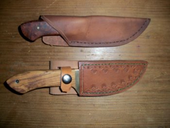

Thanks Franklin! The sheath looks ok on the front, but the back is a little sloppy... have a hard time getting the holes straight sometimes. Hopefully it's new owner won't mind too much :eek:
i wont i promise lol what helps me is i do my line in front then make holes then do the back they all dont come out perfect but there a lot better. i forgot to put up a pic of my knife in the sheath its the top pretty plain conpared to some uh hum we know who im talking about lol
Franklin, are you using an awl for your holes? I've been using a sharpened finish nail and using it in my little drill press like an arbor press. It works well when I keep everything lined up... If I'm not paying attention and tilt the sheath a little, it will veer in our out. I either need to change my method, or pay closer attention....
i use a small drill bit and drill the holes but lay my sheath on a piece of wood to keep it flat as possible,then open holes op better with a awl mark
Mark,
I use the bottom of a 1/16" drill bit sharpened to a point. When your "drilling/punching" your holes go SLOW. It does happen that the bit will flex half way through and will surely veer off messing up your line on the back side. Leather is fiberous (sp) enough that it can deflect the bit but it seems to help to go slow and allow the bit to burrow it's way through seperating the fibers as opposed to forcing it.
I've laughed, cried, and dropped nice sheath's right in the trash due to a messed up stitch line on the back side, LOL
I use wood under while drilling like Franklin but take it a step further and use wood door shims to level the center of the welt while drilling.
Hope this helps ya, Josh

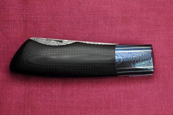

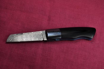

Here's what I came up with. 2.5 inch 15N20 & 1084 blade, 5.75 LOA. 1018 & N200 for the bolsters, black G10 and titanium. Scott
