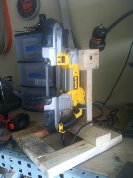

Picked this guy up today and after using Ed Cafferey's pics of his stand I was able assemble my own. Sure will be nice to be able cut steel at home!!

Thanks, should make things a lot handier
One question to anyone else using a Dewalt portable bandsaw, on the on/off trigger i am currently using a set of vice grips to hold the trigger in so i can use both hands, any other tips on a better way to do this?? i thought i had seen a pic where someone had the trigger zip tied down but my guess then was that i would have to unplug it each time and given limited space on my work bench i would have to lean over and past the saw, not what i really wanted to do

Here is my set up in pics. I built this stand for it. I have the switch tied back and run it thru a foot switch I picked up off of ebay. The power goes to the foot switch and then to the electrical box and then the saw is plugged into it. I have it pulled out so you can see the setup in the pics. It will be transferred to another bench when I get it built and I plan on mounting the electrical box onto the leg of the new bench and the cord will come up from the back, totally out of the way! The table is made from 3/16" plate steel mounted using the two screws that held the original in place.
Here is one on ebay already wired. http://www.ebay.com/itm/LINEMASTER-...ltDomain_0&hash=item19cced13c4#ht_4452wt_1344
I got mine brand new in the box for about the same price or a little less. I just kept watch and caught a deal. Mine has the wide pedal is the only difference. For some reason no one was bidding on it. I really like the wide pedal as I never have to look to find it.
On the saw i use, i tie the switch back with a zip tie. But I can slide the tie on and off the switch as i need to. It works for me. Scott
Thanks Scott, i may try that, just zip it above it and pull it down when needed, sounds good
