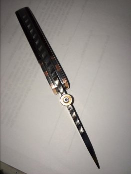

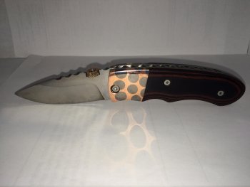

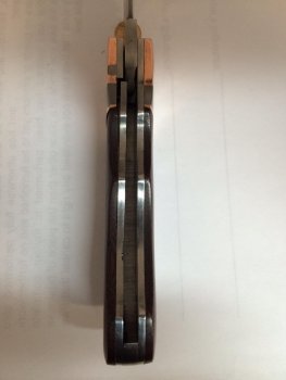

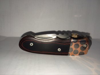

-Steel 154CM
-titanium liners are .071
-handle material is black and red G-10
-bolsters are superconductor
-thumb docs is copper with SS screw
-.187 pivot
-filing on spine
-4-1/8 closed
-6-3/8 opened
Probably my most trying knife because I hid the bolster screws on the inside which was something I hadn't done before. File work was tough to make sure it ran straight through the split where it folds, it's not perfect but it will do for a knife I will carry. Overall, I do like these folders and they do become addicting, you find yourself thinking about the next one or different ideas before your done with the one your working on! Thanks for looking, please, all comments welcome.

Looks good Wayne- liking the G10 and the file work and where did you get that wild superconductor? Nice contrasty stuff...

Thanks for all the comments guy, I wasn't sure about the superconductor and the red/black G-10, but it grew on me after a bit. I received the superconduct from Chuck Gedraitis on this site, he had it advertised and picked some up. File work seams to be something my mind is drawn to, I try to use it a lot, thanks.
