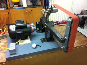

So I have been very interested in knife making for some time. I know this is out of order, but I decided some time ago I wanted to build my own grinder, so I did that. I had already posted this before sometime ago so many might have seen it.
Than I decided I needed to have a heat treat oven, so I built that.
Ok, so no more delaying....time to make a knife. It has lots of little flaws that I know I will need to improve on, but it is a decent working knife. Holy cow grinding by hand is not easy. Big respect to those who do.
Intended to be a bushcraft style knife for my outdoor hobbies. 1084 carbon steel, 1/8in thick, 1in wide, 4in blade, 8.5in overall with micarta handle. Tempered at 400F. So far, it holds an edge well but I haven't had a chance to bang on it yet.
The bug is surely bit me and I look forward to improving my skills. Thanks for all the great posts, ideas and good people on this forum.
