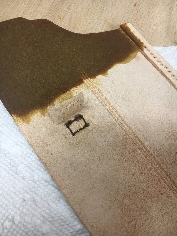

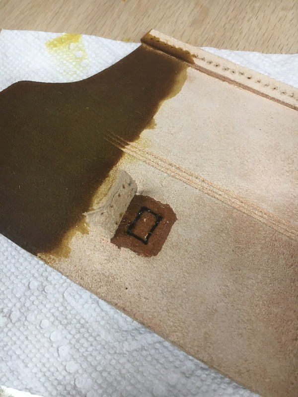

When it comes to the sheath, Gene nailed it with recessing stitches. That's something you ALWAYS need to do with any exposed stitches on a sheath's interior. I also recess stitches on the exterior of all sheaths....because there's always the chance for sheaths to be rubbed/scraped on brush, bushes, ect. in the field.

Recessing the stitches is the easiest way, and makes a neat job. I re-stain the recess slot before stitching. Tandy makes an inexpensive reloadable felt tip pen that you can add your dye to. For black, you can just use a sharpie pen.

GeneK: I'm guessing you just use a swivel knife or something to cut the flap? I think I will try this technique.
I cut the flap with a utility knife. Leather guys will cringe at this, but after making close to 100 sheaths, I don't own a swivel knife. I actually use my little band saw to cut a lot of my leather.

As far as cutting away stained leather for a stitching groove, I avoid it by staining the sheath after stitching. Then I burnish the edge of the sheath using gum tragacanth and applying a leather dressing all over.
