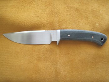

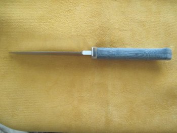

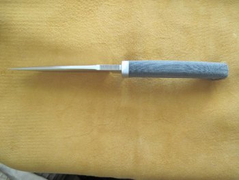

I have not made a plain stainless hunter in a long time, has a 5" blade is 9 1/2" overall , the blade is 440C 416 guard, black micarta handle, the tang was not big enough to make a full tang, rabbeted out each side of the handle material so the tang has room used two internal pins in the front and the thong hole tube in the back to keep it lined up and epoxyed it together, have a little tool I use to get any excess epoxy out of the inside before it sets up.Put it on just as you would a framed handle finished the handle and guard on the knife. Made this for a watch repair guy am needing his help, trying to make some cases for old pocket watches out of damascus, the scrappers are melting the great old gold case's. Deane
