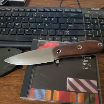

Here's one I finished today.

My first real knife has that feature. I did it because I didn't want my finger to slip over the blade. After a few years I keep thinking I should reshape that part but I decided to leave it. A learning or an advancement in evolution of my knife making.
