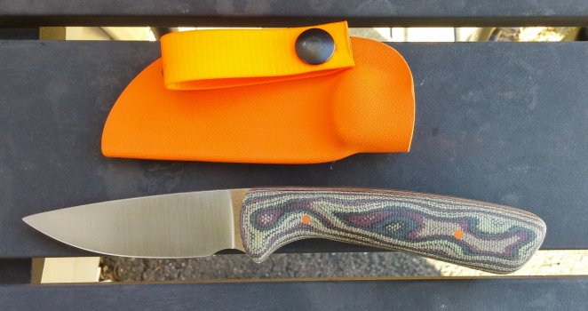

Been doin some filing. Still got one on the file jig. Think I melted some files! BTW, here's a tip : if you are hand filing and keep getting shards of metal caught in the file teeth and then get the subsequent galling on your blade, stop and clean your file real well, then run it over a chalk source. Sheetrock works fine. once the teeth are covered with chalk, file away. No more galling of your blade.DSC01763.JPG
Hey, John Wilson....recognize anything of your design ?

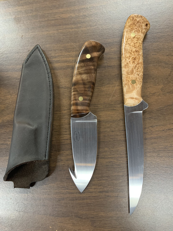

A couple of knives finished this week. The first one is a small skinner. Alabama Damascus with desert ironwood scales. Black liners and brass pins. Was made for an auction to help the family of a friend who recently passed.
The next one I'm kinda proud of. It's my first Chef's knife. I've had a lot of requests for kitchen knives so it looks like I will be making more of these. ABE-L stainless with maple and resin handle. Black liners with nickel silver pins.

Nice kitchen knife....but that handle! Amazing!
