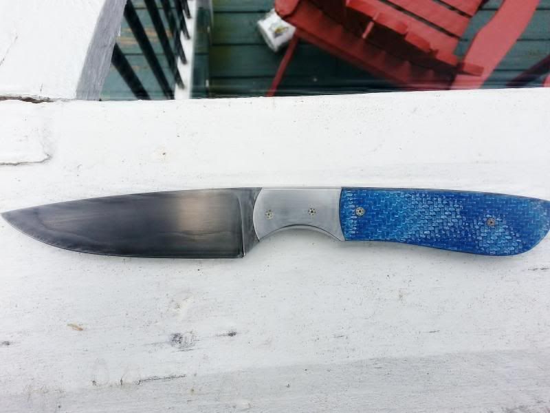

Ok here is my delema. I put a carbon fiber handle on this knife when I snaded it to levelo everything out it didnt level the carbonfiber evenly and it looks funny to me. Is there anyway to get eveything back to being level or am I stuck with it this way?
how fine a belt did you do your final sanding with and did you buff it afterwards?
for me to get it to really look good and pop, i buff with a pink scratch-less after hand sanding to 600. probably should hand sand finer.
Erik
Well, sort of sounds like to me that you didn't get it levelled out at say the 120 grit size and the problem remained throught the other grits used. Even in that 120 grit the sandpaper should be sharp and near new. Frank
