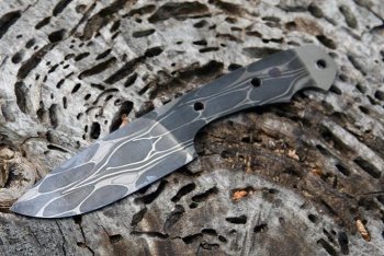

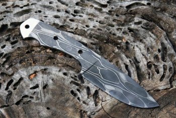

OK so I ground the blade yesterday. I went with a drop point style blade we call a Red Hawk! and I did full flat grinds. a quick dip in the enchant and took some pics.. It looks very unique! :)
Now dont get to excited. Its still gota make it through HT and testing.. But it looks like I got its welded pretty solid..
Spotted Fever sounds better the Chicken Pox ( sry Boss) so thats what we will call it for now! :) I dont think I could duplicate it again..
Thanks for looking and Happy Fathers Day to all you Dads!
Randy

I see a box full of miniatures Randy!!! Just gotta use a smaller hammer. Those could be made into little neck knives!!
That blade is spicy Randy!!!!
