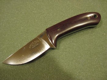

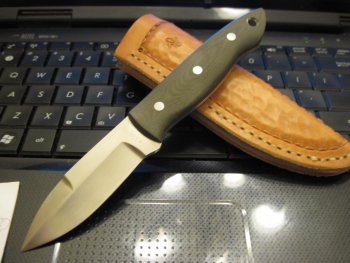

I walk through my grits to 800 grit and then polish. This really brings out the color. For a little veriation I take it to 1500 grit for a satin finish without polishing it. The picture of the tactical is green linen micarta hand rubbed to 1500 grit. The 3 finger skinner is maroon linen micarta polished. I have never used oils and such on my micarta to bring out the color. ( although it works) If you want the color..... just add a little more elbow greese and your color will pop right out at you.
If you are worried about loosing your grip...don't. I have a filet knife with polished black linen micarta that you can easily hold on to even full of catfish slime. You can polish the resin but the linen will still poke it feelers out so you can keep a hold on your knife.
