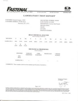

Knife kits uses Diehl Steel's W2. I personally do not like this steel one bit. The chemistry is way off from what Diehl's website says it is.
I had it analyzed, to see what the heck was going on with this steel, and if anybody's interested in the actual composition, I'll be glad to post it.
We'd be interested in both- whats the difference in the steel makeup- as well as WHO did you have analyze it.

A local Fastenal store sent it out for analysis. Here's what they came up with:
C = .96
Si = .234
Mn = .263
P = .019
S = .008
Cr = .147
Ni = .112
M0 = .025
Al = .027
Cu = .149
Co = .006
Ti = .002
V = .164
W = .028
Fe = 97.8
C = .96
Si = .234
Mn = .263
P = .019
S = .008
Cr = .147
Ni = .112
M0 = .025
Al = .027
Cu = .149
Co = .006
Ti = .002
V = .164
W = .028
Fe = 97.8
very Interesting , I have been buying thier steel ( W-2) for a few years , never had any problems ? they could have a different forge that they are getting it from . with all those alloys especially manganese it would be difficult to produce a good hamon .thats too bad ,I guess I will look for another source for W-2 . thanks for info .sorry for crappy pics my camera is acting funny
