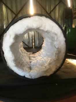

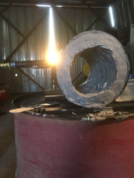

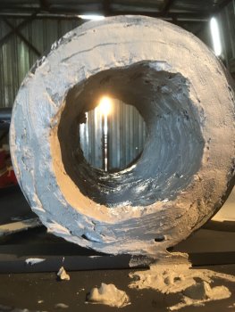

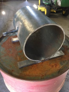

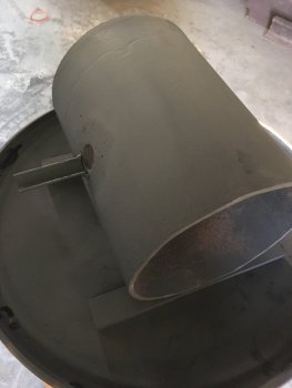

Figured I would post a few progress pics of the Forge I’m working on. Decided to go with a simple Venturi burner forge for right now. Can’t remember the diameter of the tank off the top of my head but it’s an old oxygen tank. Got the first light coating of Satanite in tonight. I always do a real thin coating the first coat because it’s so much easier to spread after that first little coat. BBF47889-78CB-47B6-A018-9DD96F629D66.jpegB514DC0A-5C0A-4CAA-98F8-D635E81AD957.jpegBD52FB6B-356B-4D31-95A4-57E2FC544527.jpeg2233A706-CB89-40BB-B66E-69C9CC7FBE78.jpegC5E08F46-C313-44E7-A026-0E0B538F7E5E.jpeg

Thank you sir. I think this is going to be just about the right size. Not so small I can’t do anything but not so big it’s going to completely guzzle the fuel

We’ve gotten so humid here lately that the coding I put on yesterday was still just as wet this morning as when I put it on. LOL. It’ll probably take another two days for it to dry enough to fire it a li we’ve gotten so humid here lately that the coding I put on yesterday was still just as wet this morning as when I put it on. LOL. It’ll probably take another two days for it to dry. I’ll keep ya updated!

Looking good Daniel! Just remember to allow the coating to dry naturally. That's always the toughest part, because it takes so long. Letting it dry part way, then firing the forge in an attempt to "cure" the coating(s), will dramatically shorten its lifespan.
A "trick" to get coating to spread evenly and smoothly...... first, thin the coating by adding water until it's the consistency of latex paint. Spritz the wool with water/spray bottle, and apply your coating with a paint brush.
Don't fall for the notion of "more is better" with forge/wool coatings. Especially for something such as ITC-100 or other ceramic coatings..... a couple of very thin coats tend to serve better than "globbing" it on. In general, with any wool coating/stiffener, anything more than a slurry coat is just wasting the product.

Yessir! I had forgotten about the trick to spread coatings. Thank you for reminding me. I will also try to be very patient letting the coating dry naturally.
