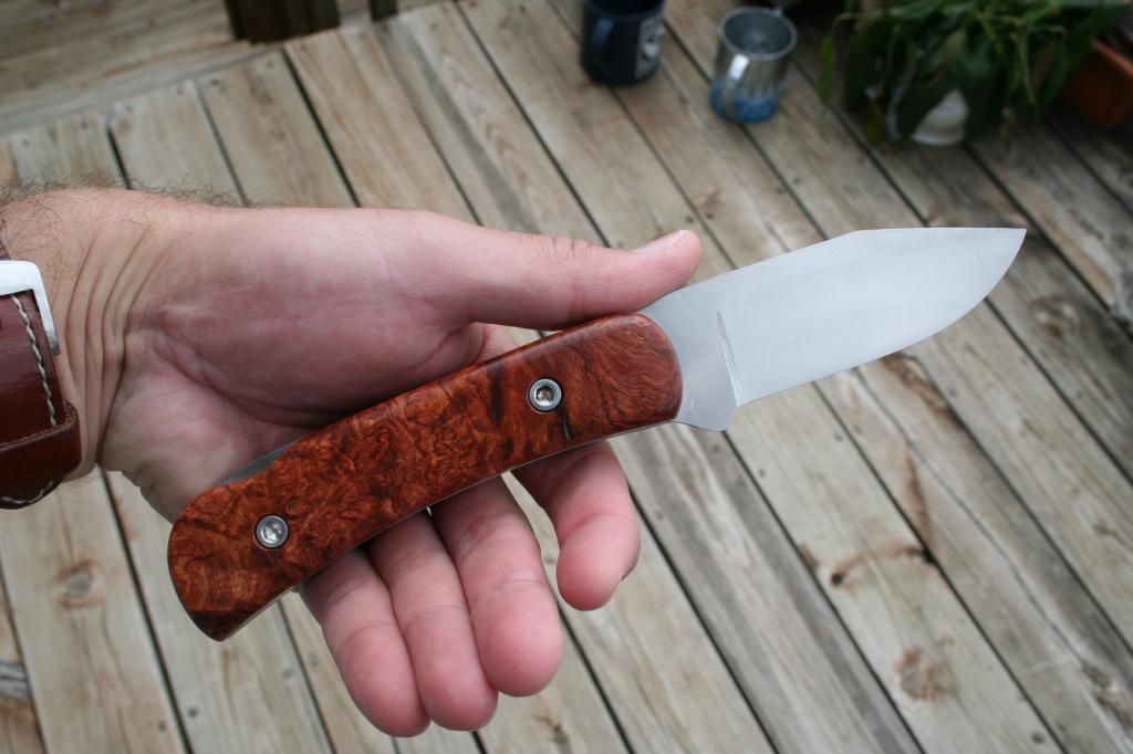

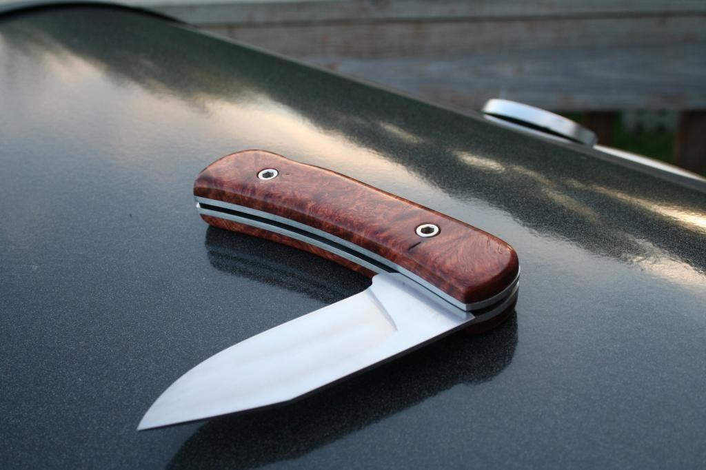

The second one took me a couple of months or more to complete. This is my lock back folder. I used thick stainless steel liner, and precision ground O1 tool steel. I used stabilized Amboyna Burl for the scales. I used a hacksaw to cut everything out, and hand files, good times. I was able to finish shaping and grinding once the KMG arrived. I finally heat treated the blade once my Paragon furnace arrived. These pics are pre heat treat with no final edge on it yet.

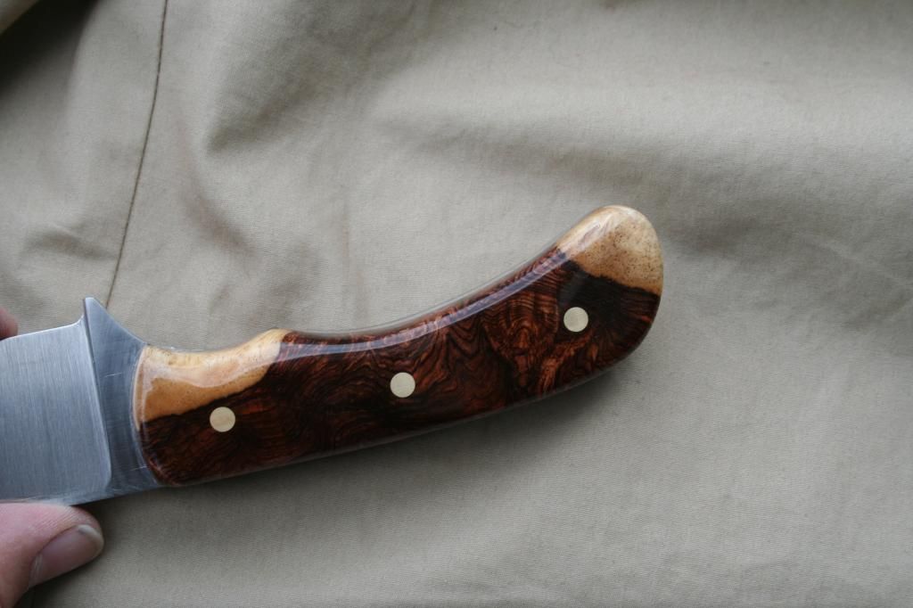

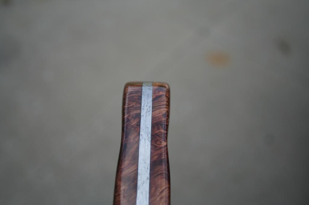

Number four is what I finished today. Well, technically I need to put the secondary edge on it this evening. This is a much thicker piece of CPM 154 with brass pins and stabilized Honduran Rosewood Burl attached via Acryglass liquid epoxy. I tried to use Bruce Bump’s how to for the CA handle finish. It is by no means perfect but I am still happy with the results and hope the next knife handle with CA finish is better. I absolutely love this one and am excited to work on knife number five soon.
