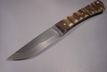

I do nearly the same way John Doyle does, only a little different
Just take a non alloyed toolsteel with 1% carbon
apply clay for repairing ovens.
place it in wet condition in the furnace.
...quench edge first, hold in the quenching fluid longer because under the clay is still red. while i move constantly back and forth, I scratch off the clay already in the quenching fluid .
not tempering over 180 degrees
.....it comes by itself.......actually pretty easy to do.
good luck
