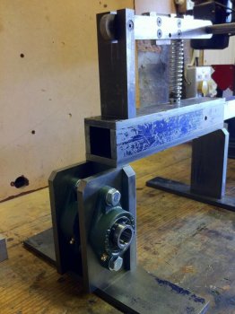

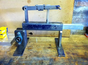

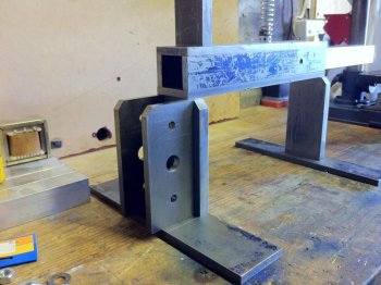

I made some more progress yesterday and managed to drill the bearing mounts with my small drill press - 10mm mounting holes and a 22mm hole saw for the drive shaft. - Even though the spindle speed was a bit higher than recommended 515rpm vs 450, I took it slow, used lots of cutting lubricant (old motor oil) and it cut perfectly. I clamped the two bearing carriers together, so the bearing mounts and drive shaft holes are perfectly aligned (I may need to open the drive shaft holes up slightly for drive shaft alignment) - if this is neccessary I will enlarge the hole with a dremel and drum sanding attachment.
I'm quite chuffed, it's really starting to come together now. I think the next thing to be done, besides getting the motor and VFD nad the drive wheel, contact wheels etc is to construct the flat platten tool arm, and a work rest.
Thanks for all the feedback so far
Rick
