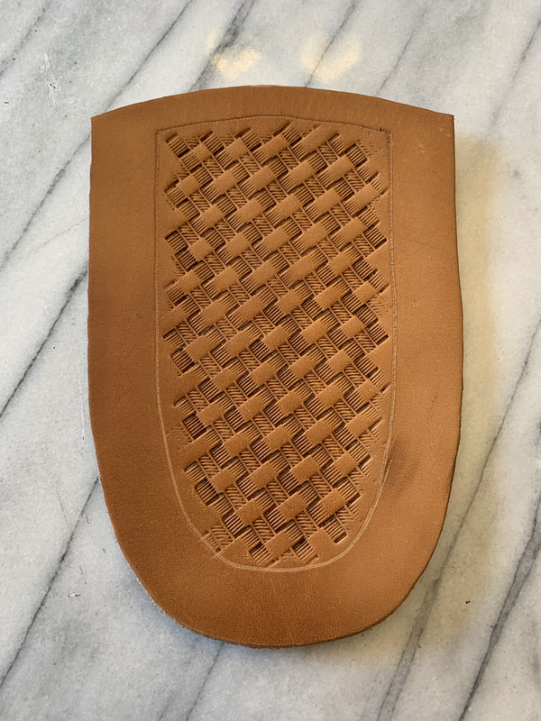

On the right side, I messed up a small part. I will smooth it out once I wet it.
Dennis Morland KNIFE MAKER Apr 26, 2020 #21 On the right side, I messed up a small part. I will smooth it out once I wet it.

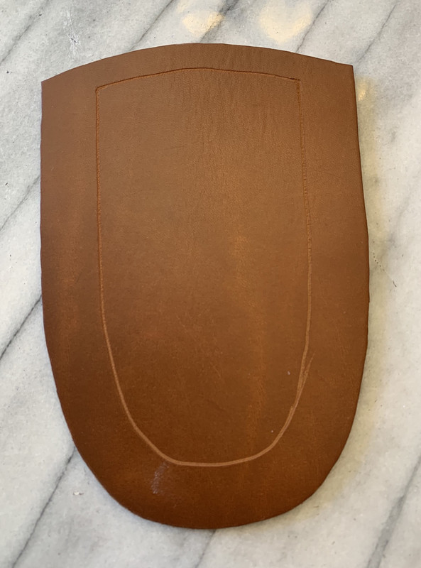

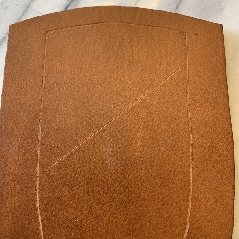

Dennis Morland KNIFE MAKER Apr 26, 2020 #22 I wet the leather. Also called case the leather. In anticipation of some simple tooling. Probably a basketweave.
Dennis Morland KNIFE MAKER Apr 26, 2020 #24 To use it. Lay a straight edge on the leather and lightly scribe a line with a small screwdriver. Like this.

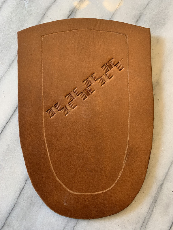

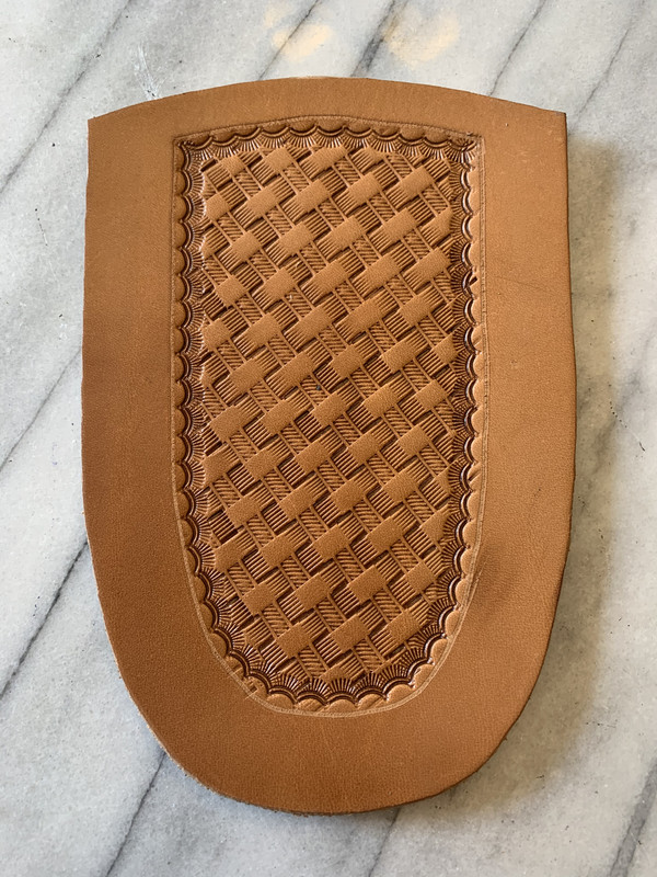

Dennis Morland KNIFE MAKER Apr 26, 2020 #26 Then alternate above/below/above/below across that line. Like this.

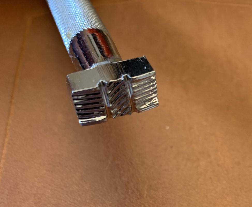

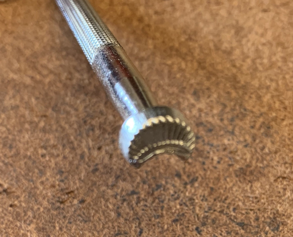

Dennis Morland KNIFE MAKER Apr 26, 2020 #29 A new stamp. I think it is called a camoflauge stamp. It is used for the edges. Just line up the lower points and go all the way around.

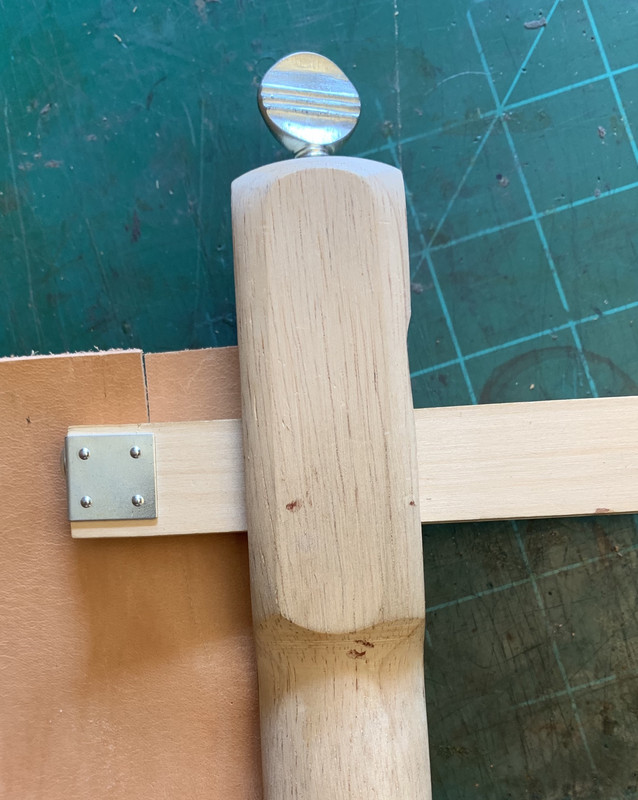

Dennis Morland KNIFE MAKER Apr 26, 2020 #32 Chris Railey said: What spacing did you use on your groover? Click to expand... 3/4 on the edge. Just short of 1/2 on the top.

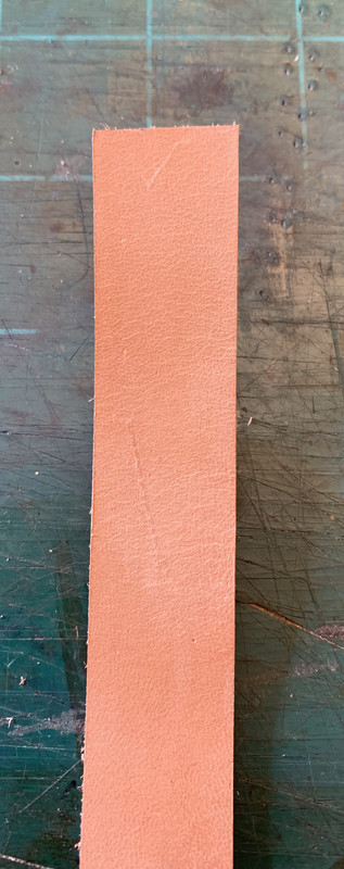

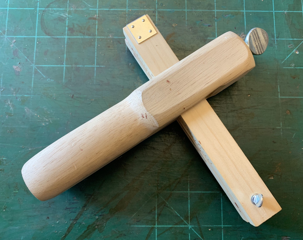

Dennis Morland KNIFE MAKER Apr 26, 2020 #33 This is a strap cutter. It cuts straps. So that makes sense.

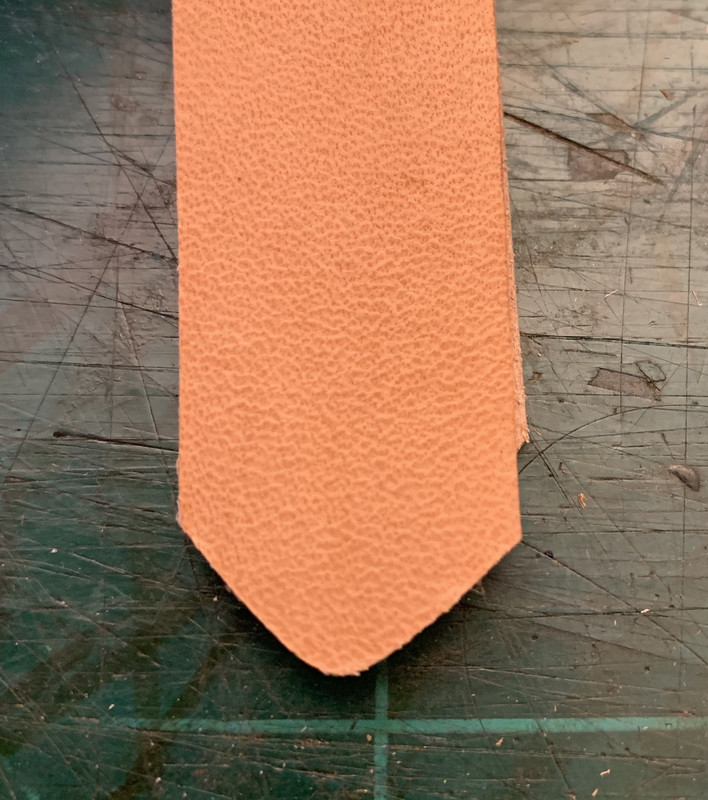

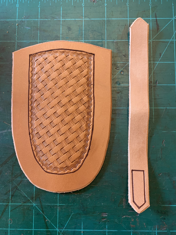

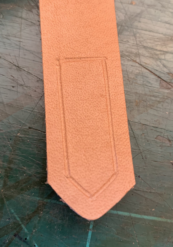

Dennis Morland KNIFE MAKER Apr 26, 2020 #35 It makes nice straight straps. This will be the belt loop.
Dennis Morland KNIFE MAKER Apr 26, 2020 #36 A simple strap will definitely work for the belt loop. Last edited: Apr 27, 2020
