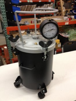

While that is cooking, I set up the 5 gallon pot I bought. I got this online for $400. I had to remove a regulator and paint pickup tube that extended down into the pail. I put on this laughably large vacuum/pressure gauge I bought from surplus center a year ago for this exact purpose. The pickup tube hole got a plug in it's place. Note here we are at nearly 29inches of vacuum. In testing it today. It held a vacuum for over an hour. Before I left the shop today, I loaded it and put a vacuum to it. We'll see if it is still holding tomorrow when I go back in.
A little better view of the top. Those bolt on things are for pressure. I am using this for a vacuum so they don't get used as you couldn't pry the top off if you tried under vacuum.

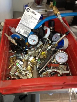

The finished conversion. I can't believe I had the bushings and parts I needed in my parts box to get this all plumbed up. It never works that way.
I have added a quick release coupling that has a ball valve connected to it. The gauge required a 3/8" to 1/4" FIB bushing adapter. This was really simple to convert. I bought this paint pot on sale for $80 bucks.
