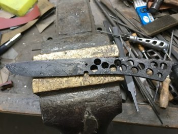

Looks good Mike!Chris this is what I needed the pins for. Fresh out of coffee etch!

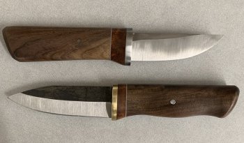

Finished the little puukko I was working on. Simple is beauty to me. Both of these knives were forged to rough shape from the same piece of 1084 steel, then finish ground. Both have walnut/white g10/mesquite handles. One has a brass bolster and the other has 416 stainless steel. They are not perfect but definitely getting better. Thanks for looking
Thank you! I don’t have a clue how I lost my calipers, both pairs have gone missing from my workbench. I haven’t tried scribing a line on the flats but that will be the next step, thank you for that!Good job on these. Your work is steadily improving. If I may make a suggestion- use layout dye on both sides of your blade. Then use a caliper to strike a line on both sides to mark where you want the top of your grind line to be. That will give you a perfect reference on each side so that getting your bevels to match on eqch side isn’t so difficult, because that’s one of the most difficult things to do by eyeball alone.
My favorite is the right one. That is my style.Recovering from a broken foot so I’ve been out of the shop for awhile but I’m back limping around and grinding. Got a few lined up. Hopefully I’ll have some completed soon. Hope everyone is doing well.
