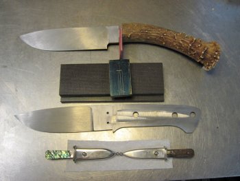

This is what is on my bench, these two need to be heat treated, top is ATS 34 with bone next is a Loveless copy in 440C going to solder the guard like back when, two mini. California style.
Nice knives! I’m a sucker for the Loveless drop point.
