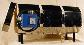

Bought this one about 5 years ago.
Only used it a few times so far, but I like it. cool 1

I have a few questions about this unit...
Is there any advantage of having the smaller unit to the large one? I would think that larger would allow more possibilities, which would be better in the long run.
Would it be possible to install a rampmaster or other kind of control later if I wanted to?
$500 really seems like a good price if it works well.

Hi Mike,
The large furnaces would have there advantages if you ever plan on making a large knife, the smaller one works great for me, it uses less electricity and I believe the heat is more even throughout a small chamber. The large one gets hot quicker, it is 220v and the small one is 110v. I can fit a 12" blade in mine on a diagonal. I talked to good kiln about the digital controller and one can be installed later and they sell the kit. You would have to contact them about the prices of there controllers or installing other brands. I love mine and heating elements & thermo couplers if you should ever need one are reasonably priced! Be great if you could drive up there and get one!

I have the larger one (the BKK - Big Knife Kiln) with the digital controller. I have been very happy with this unit and would definitely recommend it. I like the extra depth (24") to deal with longer knives, and the 220V is a plus (for me). The digital controller is easy to use once programmed. This is a good tool. 2thumbs

Eric I was looking on the web and I didn't see the digital controller. Is that standard or did you have to order it?

The digital controller is not shown on the Sugar Creek website, so I had to send them an email to ask about it. It adds $240 to the cost of the kiln. The kiln, controller, and shipping ended up around $875.

I have the 24" also, the ONLY thing I don't like is that the controls are on the side and not on the front. One pita to unpack.
