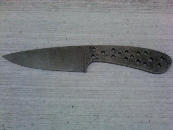

Input on my WIP
Great start there Jerry, like the style of the blade. Looking forward to the finished product.
Jerry, I think things are looking much better. You have done an excellent job grinding that down so far, especially for a first knife! Clean lines, and great plunge. With the holes at the front of the handle, you'll have to think about handle scale location so that they are not exposed. Make sure you mock up the handle and pay attention to that when you are shaping the front.
What type of handle material are you going to use?
--nathan
Thanks Bruce and Nathan! I got my knife heat treated today!! Now I can move on to finishing up the blade and then on to the handle! Nathan, I will probably be using some Butterscotch Micarta. I will post pics as I get going on it!!
Thanks again guys! I appreciate the input!

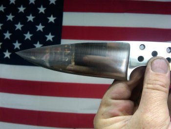

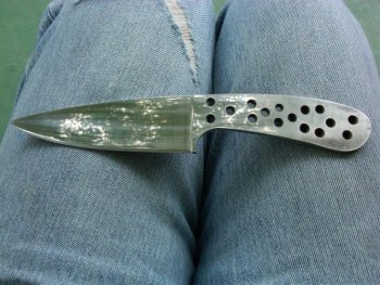

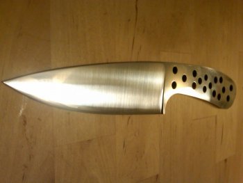

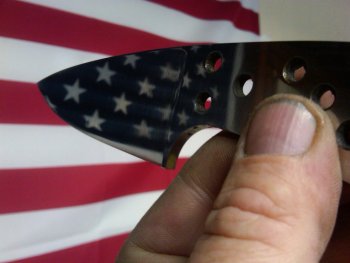

Here are a few new pics, let me know what you think!

Jerry looks like a great finish. I am on my phone and it isn't the best pic. you said you were going to us butterscotch micarta? Are you going to use pins or bolts? After that are you going to use leather or kydex for a sheath? Thanks for sharing this with us and for taking use on the ride.
James
Hi James,
I will be pinning the handle, not sure on the sheath yet. I will put up some more pics when I get to the handle.
Jerry
Wow, that's one heck of a first knife! I'm guessing you've had a good deal of experience working with your hands/tools before, and have done your homework. Or else you're just a genius, in which case, I hate you!! :D
Side-note: your pics showing the reflections on the blade are a great way to check for evenness and just plain look cool. Any flaw in the surface will show up as a distortion in the reflection. When you can see the points on the stars like in your pic, or read a newspaper in the shine, that's a good sign. 2thumbs
