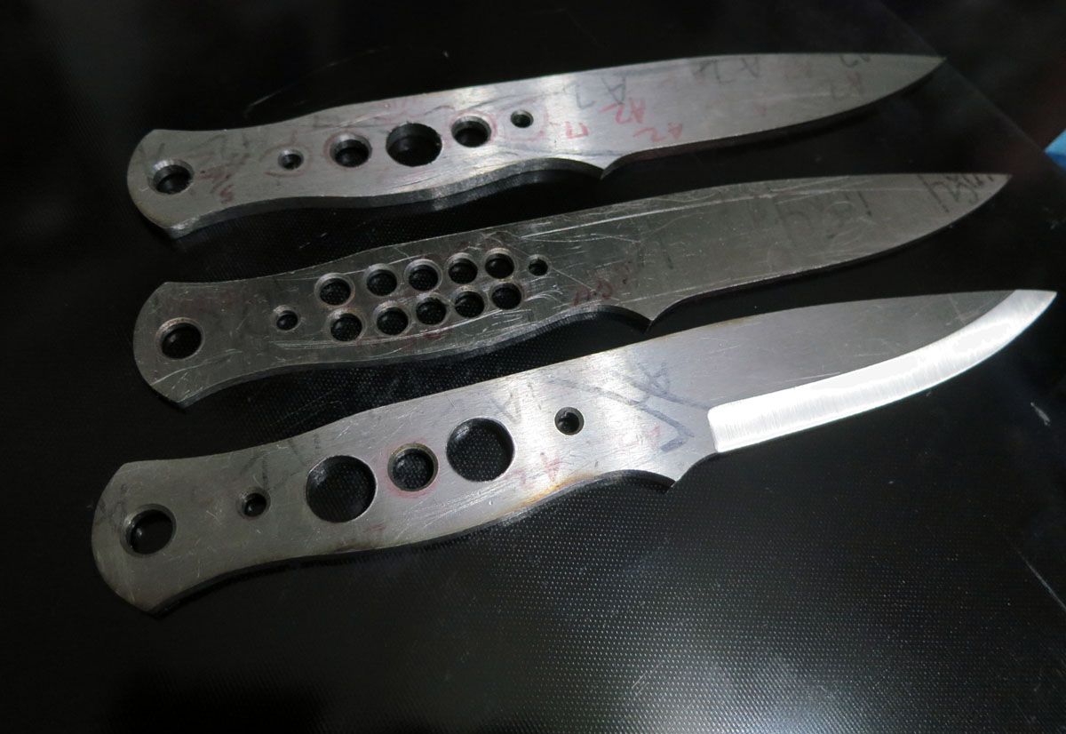

Got a little more done today. I had no idea it would take so damn long to drill holes in a handle. So that left me with only 3 done so far. The rest of the blanks are still being dialed in, I'm going back and forth between short (height) handles and medium height ones. The big choppers are on the large side, so I will bring them down.

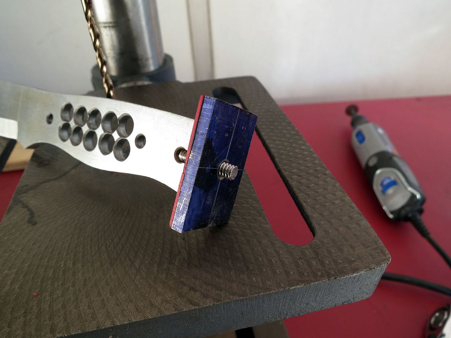

Another small update. I refined the handles on the choppers a little more, laid out the handle holes. One chopper will have a single guard made from 416ss plate and pins, and the smaller knife with a flat butt will get a threaded pommel from 416ss as well. The last two will be a first for me.
Beveled some more knives today, almost ready for HT.
Also cut more blanks for a stick tang carving knife.
Wasn't sure how these two designs I came up with would turn out, but boy I'm stoked on them now that they are starting to come to life.
Had a HELL of a time fitting up the pommel plate. Learned lots of things on this one. What a headache.
