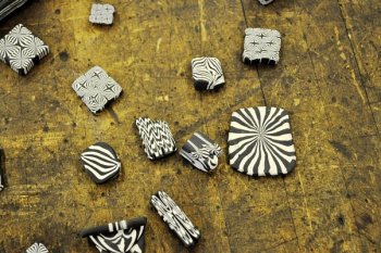

I have a question, this one came to me while I was trying to figure out what would happen once you added the 1084, my question is how do you know how a pattern is going to turn out? Is there a way to design a pattern before you start forging? I'm sure certain steps will give predicted results, for the most part, but how do you know what those steps are? Is it something you learned somewhere, or a design you thought up? Or is it all experimental? Try something different and see what happens? I guess this is called pattern development? I like to be original, I have yet to find my niche, I can see Damascus as a way to be original, if I can learn the process of how to predict how to make a pattern turn out a specific way, I don't expect you to give me a dissertation on "Damascus Pattern Development". but some books or some references to where I can find the info would be plenty, you do so much as it is, I hate to ask for more. But I know that you will give all you can and then some! I do have Jim Hrisoulas's book on Damascus, and he shows a lot of info, but I don't think I have ever seen any info anywhere about developing or creating something new or original. I have thought about it a lot, and what I came up with (so far) was to basically to experiment, once I can get my welds solid, and know what the pattern looks like without looking. Right now that's the plan, unless you can shed some light on this for me. Although experimenting with Damascus patterns doesn't sound like a terrible way to spend my time, as long as my money doesn't run out for steel I should be OK.

For pattern development try polymer clay, you can do just about any pattern. This is from a demo by Tom Ferry at the CA. hammer-in.
Scott
I use the clay technique as well -- actually play dough. What I have found best for cutting the billet is to take an old electrical cord that is made of stranded copper wire. Cut the insulation off the wire and use one strand of the wire to slice through the billet. The smooth wire and small size all greatly reduces smearing.
