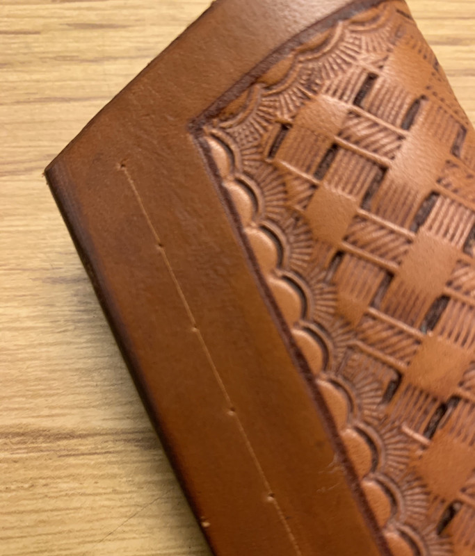

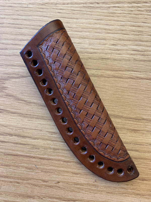

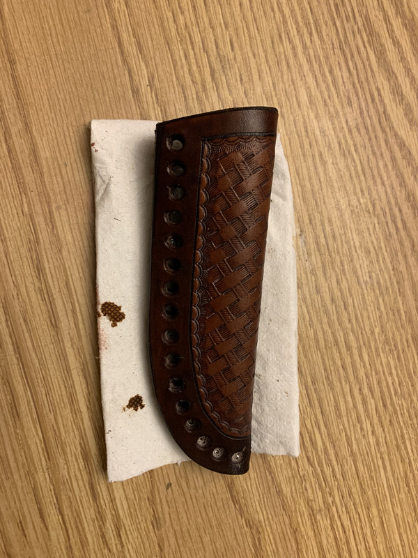

I draw a very faint line on the border at 3/8 inch.

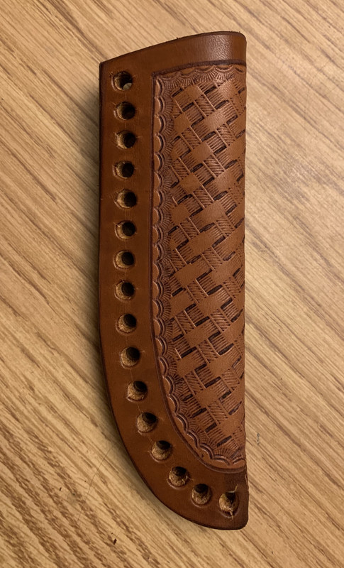

You can play around with spacing the holes closely or further away. I am going to stick with the 3/8 inch with a 3/16 inch hole. But, I place the hole closest to the top of the sheath tighter to the top so it gets a secure closure on the last braid. Then just follow the line down flipping the wing divider and making a mark.

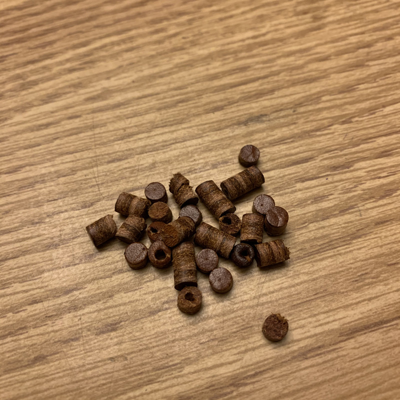

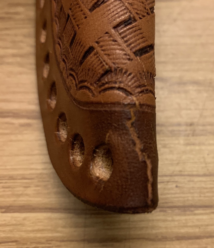

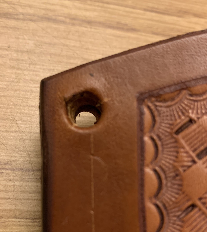

I have an admission. This leather was stiff. It is old and a bit dried out. When I punched the last hole, it stretched and split the leather at the tip. Dagnabbit!!!

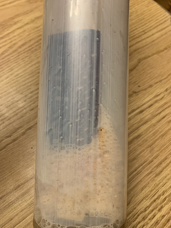

Thanks Dennis! When you come back tomorrow, can you maybe expand on your satin shene method a little? Did you just put a little in the tube and roll the sheath around in it?

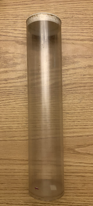

Tim - I put about 1/2 cup in the tube, I fill up the inside of the sheath, I seal up the end of the tube, I agitate (roll it around getting into all the nooks and crannies) the tube until the sheath is saturated with the satin shene. Pull it out and let it dry overnight.

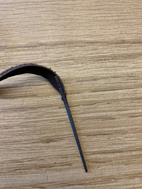

I have already cut the lace. One end is straight and flat. One end is twisted and squirrelly. I will pull the twisted end. The reason, when I finish I plan on cutting it off and it will not be a part of the braid.

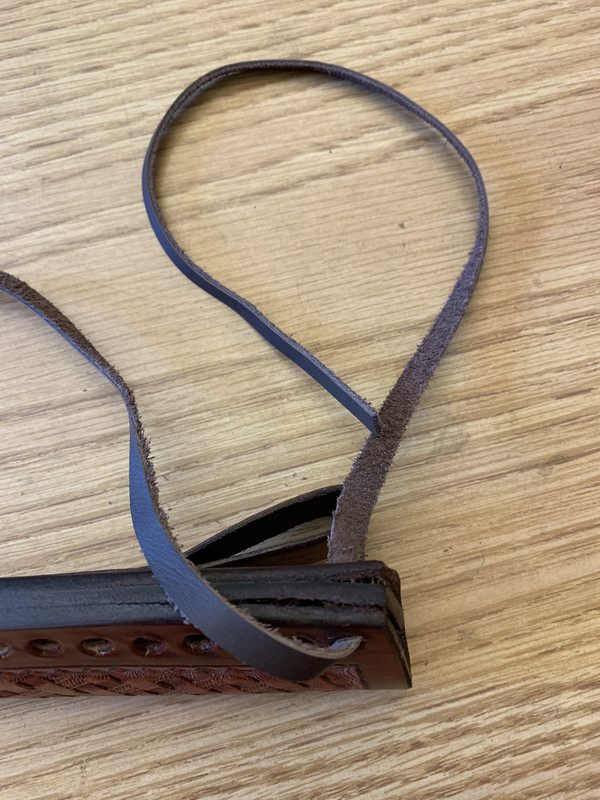

Starting on the backside (belt loop) pull the lace through hole 1 to the front side. Leave around 15 inches of overhang. This gets used later to finish the top portion of the sheath braiding. This was the good side of the lace. I start at the top of the sheath and work down.
